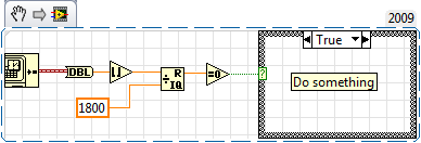

the .xls file I posted is not what my VI outputs, its just an example of what I want the output to be.
I guess I did not ask my question clearly enough.  How do I control event structures in labview such that they occur at fixed time intervals relative to the CPU clock (13:00, 13:30, 14:00, 14:30....etc)?  This is distinctly different than the way my VI currently operates; controlling events at fixed intervals since the program's executsion (13:07, 13:37, 14:07, 14:47... etc, assuming I ran the VI at 13:07).

I don't think Ben is referring to user events but rather than a more general event such as some period of time passing.  Ben, since you are using large intervals such as these, you can trigger writes when the system clock converted to seconds is a multiple of 1800 (see below):
20265i9BF41BE4154551E0
Regarding the file output, as I said in my previous reply to a similar post here, I would suggest writing the values directly to a text file in the format you desire.  This will give you the greatest control over your output.

Thanks matt, that was exactly what I needed.
