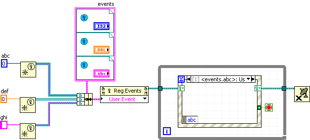

There's a trick that's somewhat similar to what you're asking for, though I don't know that it directly helps you. You can register for multiple User Events separately, or you can bundle them together into a cluster (or a nested cluster of clusters...) and register for them that way. It's really more of an organizational tactic than anything, but maybe it'll spark an idea in your head.

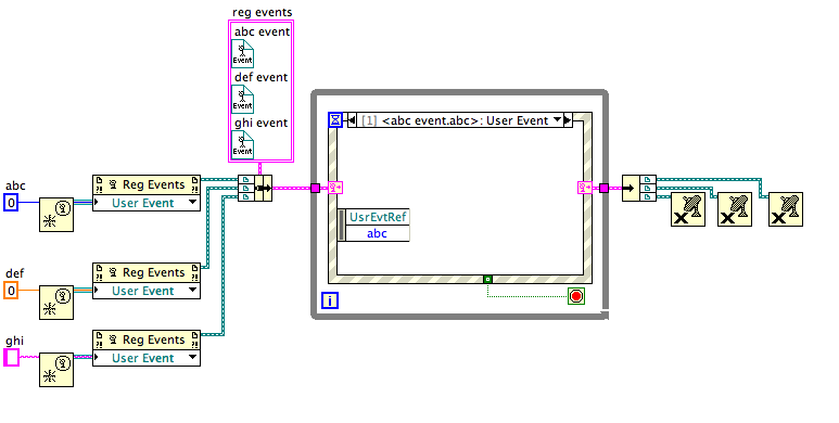

You can register each user event you create with a seperate Register For Event then bundle the output event registration numbers into a cluster.

Excellent suggestion! I forgot you could do the inverse of what I suggested.

In case anyone needs help visualizing this.
