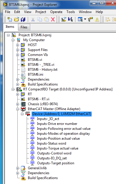

I'm trying to use a Schneider LXM32 servo drive coupled to a NI cRIO 9074 Ethercat master.
The problem is that my LabVIEW project is not showing me the full device profile.
There are 4 available PDO for this device :
1) Cyclic Synchronous Position
2) Cyclic Synchronous Velocity
3) Cyclic Synchronous Torque
4) Free switching beetween 1) 2) or 3)
BUT, I only see the firts PDO parameters after importing the xml file. If I open the xml file manually, I see that all the PDO are available.
The xml file is available in this post.
Of course, I need to operate in the 4) mode, not the 1)
Help me, please....

Hi Sébastien,
Here is a KnowledgeBase which should help you :
How Can I Modify My EtherCAT XML Device Description to Include Different I/O?
It contains useful information as well as this related link : How do I change PDO mappings for 3rd Party EtherCAT XML file?
Moreover, I found that similar cases which have been solved by deleting the XML file(s) in the following directory : C:\Program Files (x86)\National Instruments\Shared\IndComECAT\DD and then adding them again using the import tool.

Thank you for your answer.
I successfully modified the XML file of my Schneider drive :
Now I have a lot of others problems (I have made a request on NI France, I supposed you are the one who phoned me today).

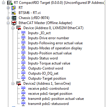

Additionnaly, see below the LabVIEW project with this device :
3) The I/O exposed for the 2 Devices (Schneider and Lti) are shared variables. But I want to poll these I/Os every 125µs. The scan engine can run at 1 ms. So, if a put a "percentage of each scan period" to 1% (the default value is 40%), will I be able to poll every 10 µs ?

1) You are looking at different devices, not different PDO mapping for the same device. That xml file contains the description for several different physical products. Expand the Name and Type folders to see what physical device the description is for.
2) See above.
3) No, you must set the scan engine to 125us. The scan percentage is the ratio of time allocated to transfering data within the scan period. 125us is quite fast-you may need a performance PXI depending on how much data you are reading. Also, only drag the variables that you need to read to the block diagram.
4) It is much easier for supported Softmotion drives. However, Softmotion simply ties into the ethercat driver and is not necessary.

I tried the moded file "LUST_22_SO.XML".
I still don't understand :
-why 4 devices are exposed (I have only one motor)
-how access more variables.

Hi Sébastien,
1) The manufacturer often stores the information for multiple devices in a single file.
2) I am not sure exactly what PDO you need, however the XML file only stores the PDO mappings that each drive supports by default.
We would like to integrate this functionality into the ethercat driver and have it on our feature list. However, right now the PDOs have to be switched with a text editor. There are some xml editors that make it easier, like notepad++
3) The torque mode is explained in the manual but I don't see the PDO mapping in the XML file. I would expect that PDO to be in the XML already, but, if not, it can be added. How are you writing to that particular object? I assume you have found the SDO examples?
