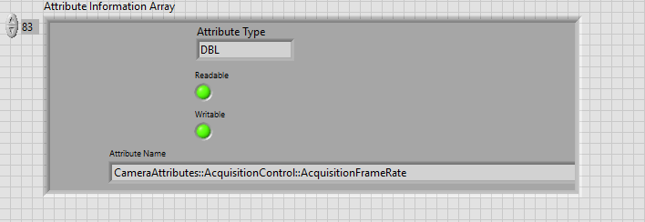

I'm able to connect the cameras successfully and the program runs without errors. Next, I want to add controls in the front panel using which I can directly control camera gain, exposure time, frame rate, etc in labview.
But I'm getting error after I added these controls. I think I am not clear on how to add these attributes correctly!!
I looked at some posts online and understand that first I need to find the exact name of the attribute and its data type correctly. To do that, I used the "enumerate attributes" and found the correct attribute name for Gain, exposure and frame rate and their types as shown in the snapshots below:
Then I inserted property node (snapshot below) and added indicators with the names and values as found above. I have attached my code. But still I'm getting the error "Attribute Not Supported by the Camera".

You need to set the property nodes to "write" mode. Then you need the value of the string to be the property name you have found (right now it's the label). You will have to change your DBL indicators (Gain, Exposure, and Acquisition Frame Rate) to controls.

This was a perfect solution!! I did all three things as you said and it worked!! Super thanks for your quick response and helpful insight!!
For anyone facing this issue and who lands on this post, here is a snapshot showing the changes I made as suggested by Gregory, which made it work:
1) To set the property nodes to "write" mode, you have to right click the property and select "change to write". And you will see small direction arrow to the LEFT of the property now!!!
I found the following from the help file: " A small direction arrow to the right of the property indicates a property you read. A small direction arrow to the left of the property indicates a property you write. Right-click the property and select Change to Read or Change to Write from the shortcut menu to change the operation of the property."
2) Right click on the property --> Create a constant and then use the property name found from enumerate attributes, as the value of this constant: for example: CameraAttributes::AnalogControl::Gain
3) Lastly, change the DBL indicators (Gain, Exposure, and Acquisition Frame Rate) to controls by right clicking on the indicator icon and selecting 'Change to Control'.
