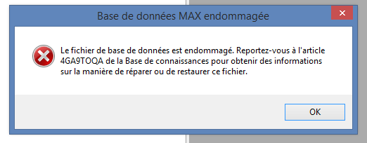

Went I open NI MAX, this error appear.
And When I select my cDAQ Chassis I have this,
Please what Can I do because I can't use my cDAQ ?

First, can you go into "Services" on your control panel and make sure all of the NI services are running?
Second, can you try resetting the MAX Database?  Note that this will delete any settings you had stored, so make sure you have anything vital documented so that you can restore it manually later.
