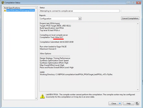

Error compiling FPGA on cRIO 9111 due to Compilation Xilinx tool 14.7 and not 10.1
I have a cRIO 9012 with FPGA 9111, Labview 2016, OS Windows7.
When I try to compile the FPGA Vi I receive the error as in the following page
It looks like Compilation Xilinx tool  is 14.7, even though I installed the Xilinx 10.1.
How can I remove the 14,7 which is not visible in the installed Labview software?

The compile tools needed depends on the actual hardware target. You cannot force a ISE 14.7 defined target to compile with a different toolchain.
My guess is that the hardware target is designed for ISE 14.7 To compile, you will need to install 14.7.
I cannot verify if this is intended, the information is really hard to find on the NI website, so I'm assuming it's not just a bug..... ISE 10.1 is a really old toolchain, I haven't had to use that in over 10 years, and even that was for a really old target at the time.

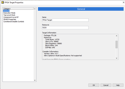

For example, a Virtex 5 target is ISE 14.7 from LabVIEW 2012 all the way to 2025. Once a target is designed for a given compile chain, it typically does not change over time because that would be a monumental effort from NI to maintain.
You can look under "Properties" of your FPGA target iny our project and it will tell you which toolchain is required for the compilation. Here is my current target telling me that Vivado 2021.1 is required, even though the "current" version of Vivado is newer. I have four different compile tools installed due to support for different hardware, ISE 14.7 and three different Vivado versions.
Here is the same info for a Virtex 5 target (LV 2025 Q3).

I have solved the problem.
1) I have installed ISE 14.7, I thought that it was already installed.
2) I have installed the LV 2016 patch.
