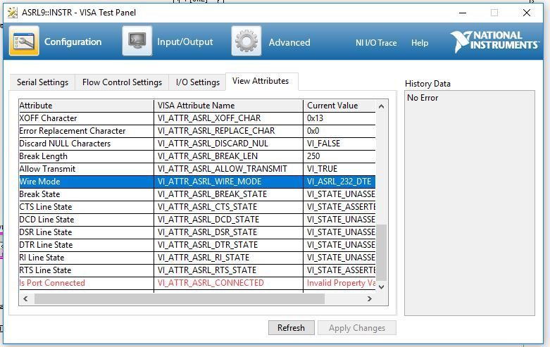

i try to connect with an old temperature measurement device. I use an USB-RS232 Apdater.
I was able to read out the temperatures with the Visa Test Panel from the NI Max, after i tried several different settings.
So i tried to copy the attributes from the NI Max and set them also in the Configure Serial Port.vi
In the end i have a problem with the Property Node(arg 17). This is the setting in the NI Max:

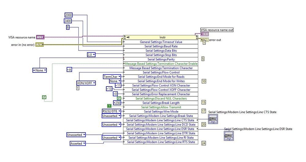

Here are the settings in the Labview.vi ; the numbers of the property node i hope are right?!Her
Here you can see the error in the Labview program.
I tried also the other possible settings at arg 17 but i always get this error code.
Can someone help me with that? Why there are this differences in VISA test panel and Labview?

You are setting too much properties. Use the VISA Configure Serial Port.vi.
I never needed anything else in the last 14 years.

Hi Paolo,
thank you for you reply. At the beginning i was trying it like your propose; in Labview and also in VISA test panel.
Read out was in both programs not possible, but i got no error with VISA Configure Serial Port.vi

Then use the properties to set the DTR and RTS states.  But don't set all of them.  Apparently your serial port doesn't like the RS-232/DTE setting, so you should definitely NOT try to set that property.
(2,559 Views)
You are right... i was only pulling out arg for arg of the property node and not setting the args which i needed.
Now i set it right and read out is working well.
Thank you for your help!
