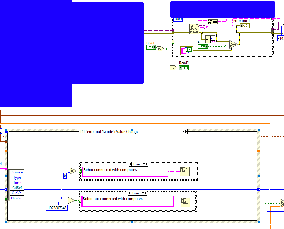

Why  NewVal 2 not working, and event case works only in timeout?

Events are for controls, not indicators.
Why not create an event for the boolean instead?
This code makes very little sense overall. Can you explain what it should do?
(You can fire events by writing to a signaling value property, but I doubt you need that)
Message 2 of 9
(2,008 Views)
I need that will be sent me an error message.
For tests, I create "s" button because the robot now is not here, but events do not work2023-04-23_11-03.png
Your control is  s   you have an indicator error out 1

And how can I send error messages with events?

The event only captures the front panel action of control by default. If you want to trigger an event programmatically, you need to use the Value (Signaling) Property.
Check for user events.
You can generate events programmatically on your demand.

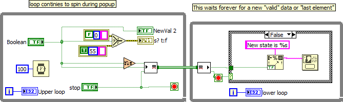

If this is not a button, but a value coming from an instrument, you just process it according to the dataflow. Since you need to poll that value, your loop needs to spin anyway. No event structure needed at all.
Since you fire a popup only of the value has changed, use the "is value changed" primitive from the comparison palette.
If the popup should not block the loop, use a notifier, queue, or appropriate channel wire and handle it in a separate loop.:
Let's have a look at your other code:
Are you aware that you only need one case structure and wire the numeric directly to the selector. Make one case 0, one case, -10738etc... and one the default
Here's how it could look with a channel instead:
Message 9 of 9
