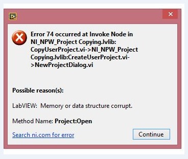

I have the same error for cRIO...I get error 74 though... Can someone help?cRIO new project error.jpg

Have you ever been able to program your cRIO/ myRIO or has this roadblock always been here?
What versions of software do you have? Go into NI MAX expand the software tab and post a screenshot here.
I need more context of what is going on to be able to help.

For me, the problem was that I had the wrong software. Instead of the myrio/labVIEW bundle, I only had labVIEW. When I first started using the software, I had a trial version of myrio so it worked for a couple weeks, then stopped once the trial expired. When I got the actual myrio software, everything worked. I would suggest looking at your software and making sure it's not the trial version.
Hope this helps!
