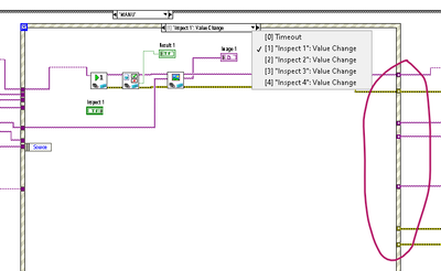

I'm developing a LabVIEW (2023) application to control 4 cameras, each associated with a separate VBAI inspection.
During the initialization phase (INIT), I perform the following steps for each camera:
  1. Launch VBAI Engine
  2. Open Connection
  3. Open Inspection.vi (each camera has a different .vbai file)
  4. Store the 4 sessions using Shift Registers
In the Event Structure, I have one "Inspect" button per camera.
Each event retrieves the correct session, then calls Run Inspection.vi, followed by Get Result and Get Inspection Image.
Problem:
  • During execution, Open Inspection.vi throws error -354804.
  • If I force the run, Run Inspection.vi later throws error -354706 ("inspection not open").
  • The path to the .vbai file is hardcoded (not relative), and the file does exist.
  • No Close Inspection or Close Connection is called before running.
🧪 Observed behavior:
  • On the first click on "Inspect Camera 1", everything works fine.
  • But when I click on "Inspect Camera 2" (or 3 or 4), the image does not display, and I get an error from Open Inspection.
  • Then, going back to "Inspect Camera 1" → it no longer works either.
  • However, if I only use Camera 1 without touching the other "Inspect" buttons, I can repeat the inspection many times with no problem.
This makes it look like triggering another camera's inspection breaks or corrupts the previous session.
What I've already checked:
  • All .vbai files open correctly in Vision Builder AI standalone.
  • Launch and Open Connection return no errors.
  • The sessions are stored and propagated correctly via Shift Registers (confirmed with indicators).
  • I’ve set Wait Until Done = TRUE in Run Inspection.vi.
My questions:
  • Has anyone encountered error -354804 when calling Open Inspection.vi, even with a valid path?
  • Are there any restrictions regarding file names, path length, or character encoding?
  • Could multiple parallel sessions cause conflicts if not managed or synchronized properly in a While Loop with Shift Registers?
  • Is it necessary to synchronize Run Inspection calls between cameras to avoid conflicts?
Thanks in advance for any suggestions, advice, or working code examples using multiple VBAI inspections in LabVIEW.
Salim
Salim28_1-1750797256677.pngSalim28_2-1750797479179.pngSalim28_3-1750797542277.pngSalim28_4-1750797590273.png
Not true, you have to wire the session refnums through all event cases. The original refnums are lost after Inspect 1 event executes.
(257 Views)
You're exactly right, the application is executing correctly. Thank you very much
