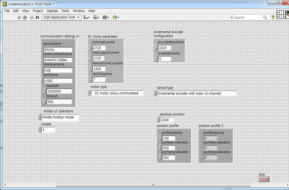

I`m programming Maxon motor controlling with EPOS 4 position controller via LabView.
However, during basic programming, this error has occurred.

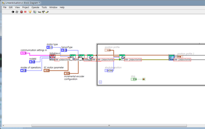

(On the block diagram it appeared as ERR268343459 and "Handle is not valid 0x10000003 in error out box of front pannel)
Program is not stopped by this error, but error is occurred at "Initial" block and keep going to next block.
Of course motor was not actuated.
How can I solve this problem?

You will not see the Maxon EPOS4 in NI-MAX. The error is generated in the Initialize.vi and is reported by the VCS Set Protocol Stack Settings.iv (this is where the baudrate and timeout is set). Since this vi receive an invalid handle the problem is probably (my guess) with the interface name, either the port name is not USB0 or your EPOS is not configure to use USB protocol. The first thing to do would be to connect to it using the EPOS Studio application from Maxon.

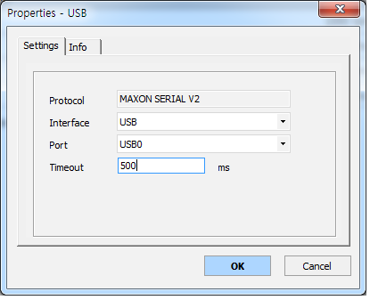

As your advice, I turned EPOS4 Studio on and confirmed the connection.
That was like below.
Red square shows device information on EPOS4 studio.
These windows are property of my device. With these communication setting, I could actuate my motor on EPOS4 studio.
(Interface, port and NodeID has the only one option - USB, USB0, Node 1)
And finally this is my labview monitor. Unfortunately, with same communication settings as EPOS4 studio, same error is still occurring.
I try to find other solutions for myself now. If you have another opinion, please reply on this comment.
