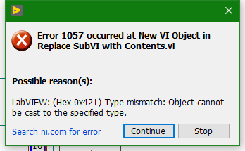

Error 1057
Why does this:
give me this:

There is a difference between a Flat Sequence Frame and a Flat Sequence Structure.  I'm guessing you want the reference type to be Generic->GObject->Flat Sequence->Flat Sequence.

The incoming object is not a diagram or sub-diagram of a structure object?

Hi Paul,
The correct class is "FlatSequence" (Generic -> GObject -> FlatSequence).
The class "FlatSequenceFrame" is for the frames of the FlatSequence.
Raphaël.
