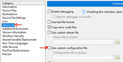

Something else I just thought of.  Since it appears to have a problem during the "Create INI file" portion, can you check the build spec(s) and tell us if you use a custom configuration file?
If you do, try turning it off and see if you can build.  If you don't, try creating a dummy INI and select it.  Either way, if doing this changes something, it'll give you something to look at more directly.
