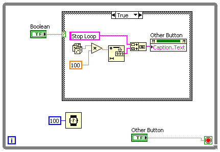

I have a button whose text I would like to constantly change based on
whether or not other buttons are pressed/depressed.
So I wired up all the conditional buttons to a couple of nested AND
vis. Now I have the output
of a single AND that has TRUE (yes change the text of that other
button) or FALSE (leave that other button text alone).
I also created a property node for the button whose caption I want to
change.
My question is, how do I connect these together. The property Caption
takes in a string, which would be fine, I could
create a constant string equal to the new text, but how would that
connect to my boolean operator?
BTW, is there a n-input and gate available?

>> ...how would that connect to my boolean operator?
Use the Select node found on the Comparison palette.
Yes there is. Look on the Boolean palette. It's called Compound Arithmetic.

Case Structure.
Look at below.  The false case as nothing in it since you said you don't want to change the caption if the first button is false

Thanks!
I have a long way to go in learning Labview... I wouldnt have never
come up with a solution like that! 🙂
