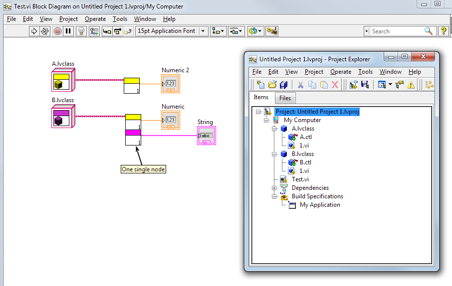

I think now I understand better. What you want is essentially something like the following, correct?
Essentially, you're talking about extending* the API of a class by inherited classes, yes?
* Terrible term, because it refers to inheritance in some languages, but it seems fairly accurate here. Maybe expanding or augmenting is a better term.

Tst, thats pretty much it. The exact details of the implementation are unclear to me regarding what would be best but your image certainly conveys my idea pretty well.

Let me see if I can restate it in my terms.
You have class A.
You have class B inheriting from A.
You have a method 1.vi on A. It has N outputs.
You want to do something to create a "1.vi" [although it need not have that name] on B and associate it with A such that if you drop A's 1.vi and wire a B to it, you get N+M outputs, where M is more outputs contributed by B.
Yes?
I have never heard of any such thing in any programming language, nor have I ever felt the need for any such, but that doesn't mean it isn't a valid need -- text is often quite limited in what it can do compared to a reactive graphical environment, and my imagination may be limited by past experiences.
Let's use the term "expand" -- you're expanding the number of terminals that a method has if it is wired with a child class.

Youre getting closer, but no cigar yet. Your example alters the behaviour of the class in code using the class. I definitely do not want that.  The new functionality should only be visible or usable within the class itself.
I dont want an expandavble terminal at all even though tsts example looks nice.  I would (as i have stated many times) like something akin to call parent method (but free from any oop connotations that may have) where I can simply (in the class properties) state that for class feature X, this is the vi responsible on this level. Then, instead of having a multi-node as in your diagram, the prpgrammer can easily access the responsible vi for the previous level of the hierarchy and process its output accordingly.  I would tend to look at a single vi with a single connpane where any concatenation or appending is done subsequently at each level.
Class a.get properties.vi would return data A.
Class b.get more properties.vi can access A through my new pseudo call parent method and add data B to it to output A+B.
Class c.get even more properties can access A+B trhough my new pseudo call parent method and adds data C to output A+B+C.
