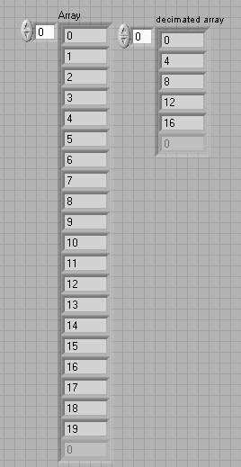

I was thinking something as simple as this:
Just read the lvm, decimate the array to purge unneccesary samples and then write it back to another text file.

Thanks a lot, problem solved

If I am reading the description for this this will only help if you are decimating in one dimension. I have and LVM that (again the rate function was not corrected)  I have 1.6k points for 15 seconds for 8 segments with 3 columns of data. I would like to compress it to 20 points per second. Any suggestions?
(3,648 Views)
You can do the same thing for each column of the LVM file, assuming that sort of decimation is OK.  That will depend on your data and what you need from it.  If you can just throw away data, you may want to consider averaging, instead.  Also, the above example loses any timestamp information.  If you want to retain this (assuming it exists), convert the DDT to an array of waveforms instead of a single Y array (or 2D array), decimate the Y components of the waveforms, rewrite the Y back into the original waveform, then save to LVM.  This is pretty easy to do with a FOR loop modification to the above code.
