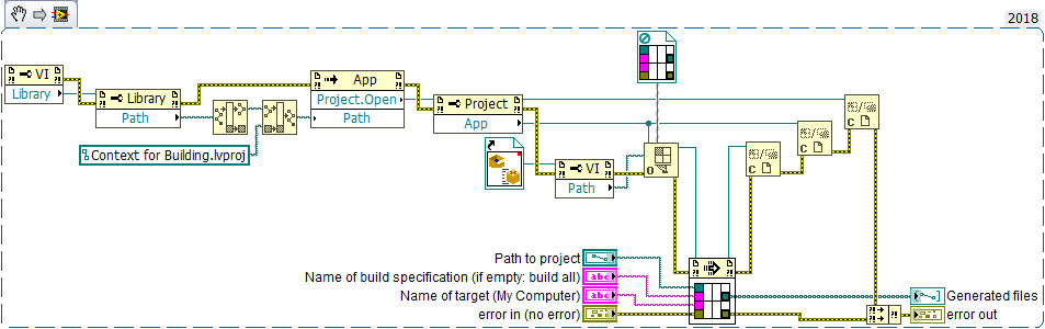

I have been working with the app builder API to do some build automation experiments. When I use the Build.vi on an installer build in my project, it hangs. I have left it overnight and it didn't complete. The application builds work fine.
Does the build.vi work with installer build specs?

Yes, it works.  I've used it to build installers without any problems (I wish I could figure out how to get it to display the progress dialog though).
My wild guess is that there's a hidden dialog box waiting to be dismissed.  It might have something to do with the context that the builder is running in.  Try something like this:
(2,229 Views)
You called it correctly. Your suggestion made me try running the installer build by hand as it were. A pop-up window came up telling me some files in the cache required admin privileges to access. I had never seen this before. It is not surprising the build failed, but that is a nasty way to fail.
I will try your context code to see if the pop-up shows there as well. That at least would give the operator a chance to fix the problem.
