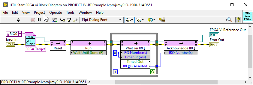

TARGET LV-RT Example.pngStart FPGA is a little utility I wrote to start the FPGA code and wait until it starts running.  In here is where you reference the FPGA you want to run.  I like to point to the FPGA VI file, but as others have noted, sometimes this doesn't work, and you have to point to the BitFile.  It is a mystery to me why it works sometimes, but not others.
