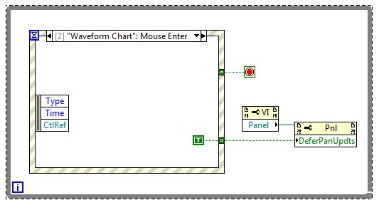

Disable automatic scrolling of waveform chart
Whenver new values are added to a waveform chart, the chart scrolls to the end in order to display the values, even if the user has scrolled to view older data.  If the user is holding on to the x scrollbar, the chart jumps to the end for a second to update the display, and then jumps back to the scroll position; if the user is not holding on the the x scrollbar, the chart just jumps to the end and the old view is lost.  This makes it virtually impossible to view historical data from a live updating chart.  Is there a way to disable this autoscrolling?  This seems like a pretty basic issue that I would have thought I would have run into before, but I just can't figure out how avoid it short of using a waveform graph and buffering the data myself.

Hi jsiegel,
One way would be to defer front panel updates when your mouse is on the chart's scrollbar. Below is the event loop to achieve this (not shown: the parallel loop containing the chart) :
The event case is set to Mouse Enter on the Waveform Chart, with another case set for Mouse Leave (which sets the Defer Panel Updates back to false)
This means that no data is lost and you can scroll through the chart's history in peace!
Hope this helped.
-CC

P Anand - wouldn't that mean that any new data acquired during the 'pause' would be lost as the chart wouldn't be being updated?
You'd end up with jumps/gaps in the data at the points where you'd pressed the pause button and these gaps would be worse the longer you kept the chart paused.
-CC
