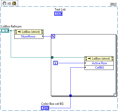

You need to expand the node to include the property "Active Row", and wire an input to that to change the CellBG colour.

If the Active Row property is set anywhere previously in the VI, even in a previous run, you'll be able to change the colour of that cell using CellBG on execution of the code. If you want to change the colour of a specific row, you have to declare which row you're trying to change. If you want to change the background of all the cells programmatically, you'll have to do something like the following:

Thanks it works fine. That means when all the active sensor is same color then only it will change the background color.
