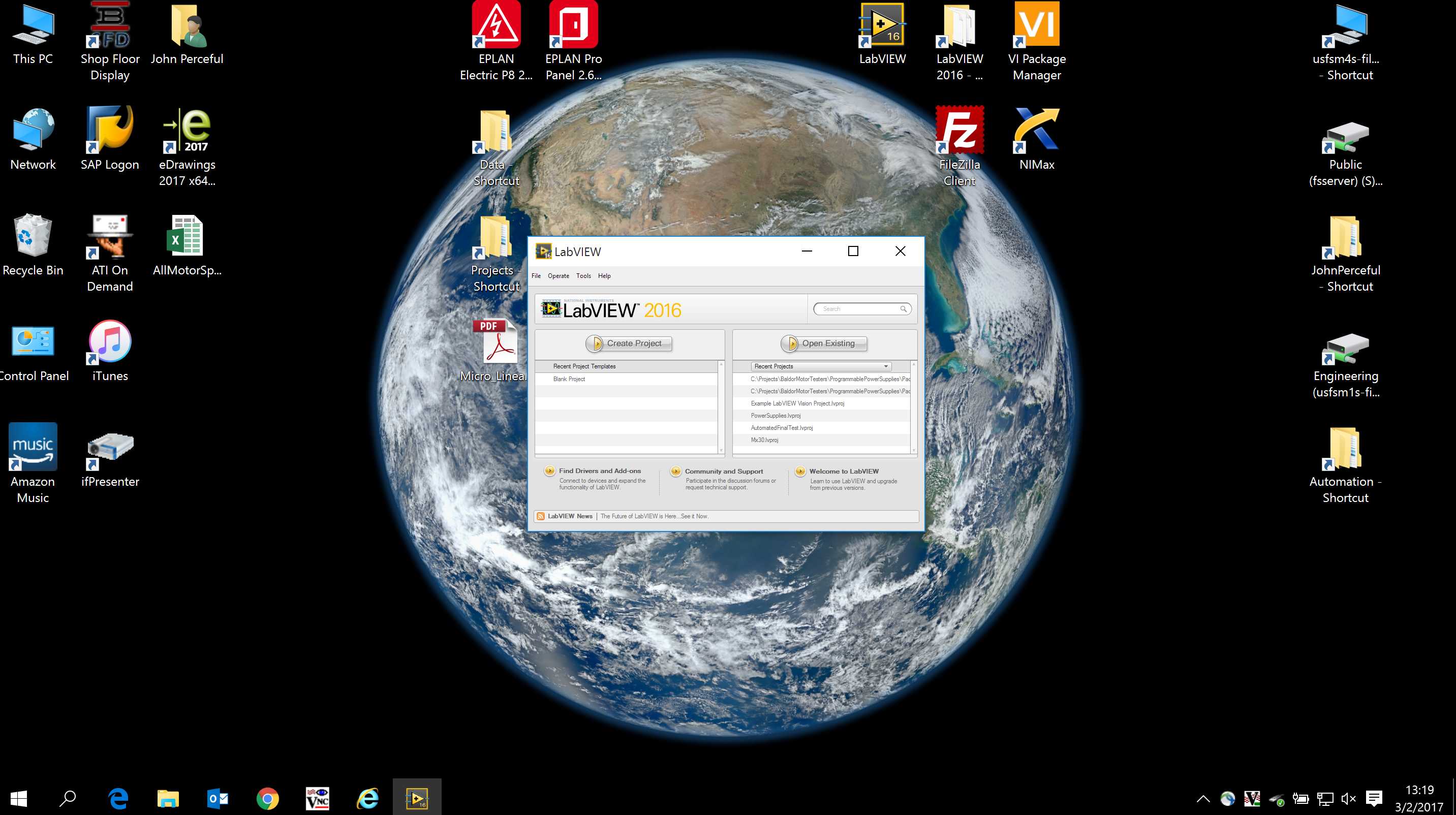

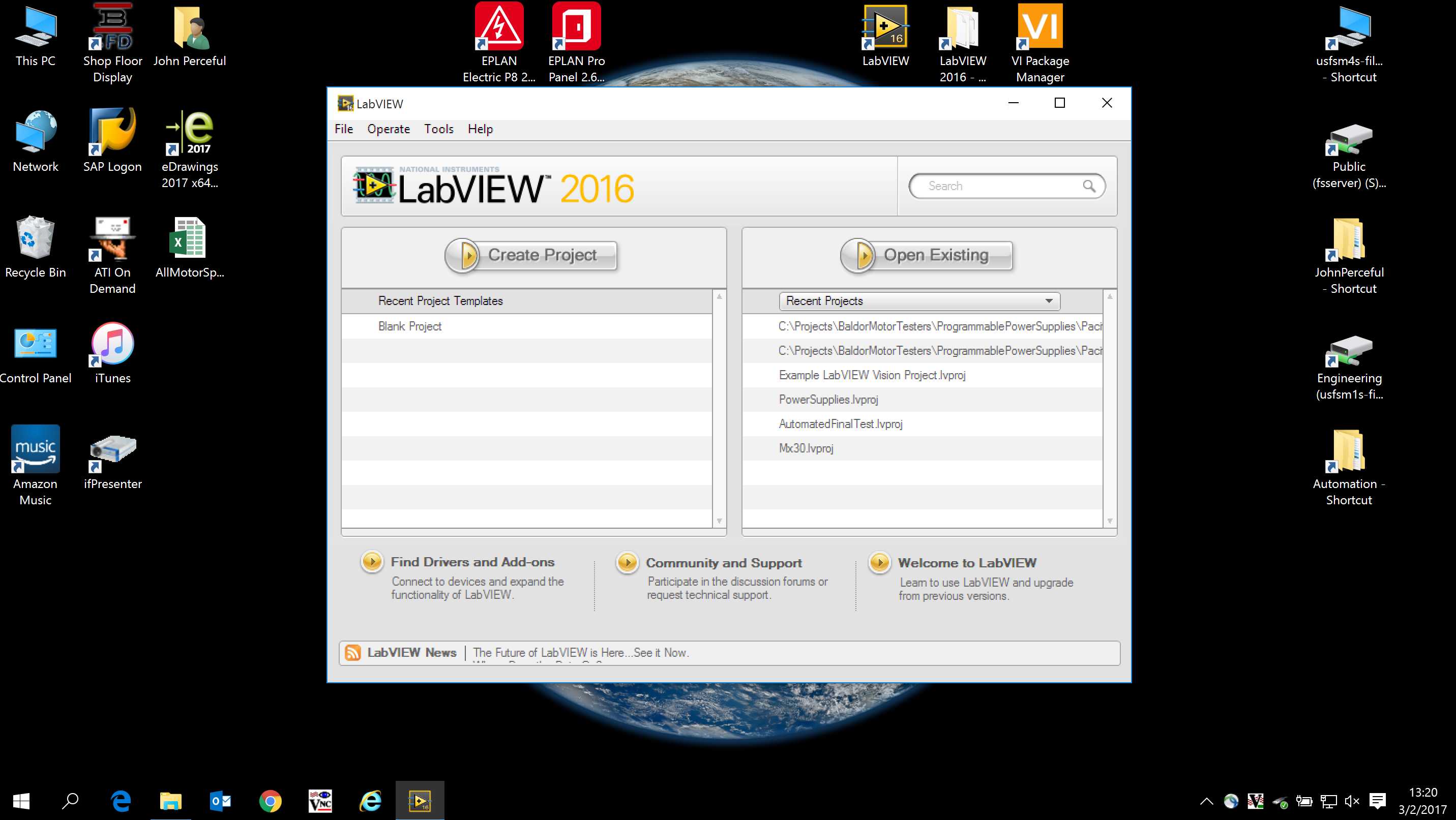

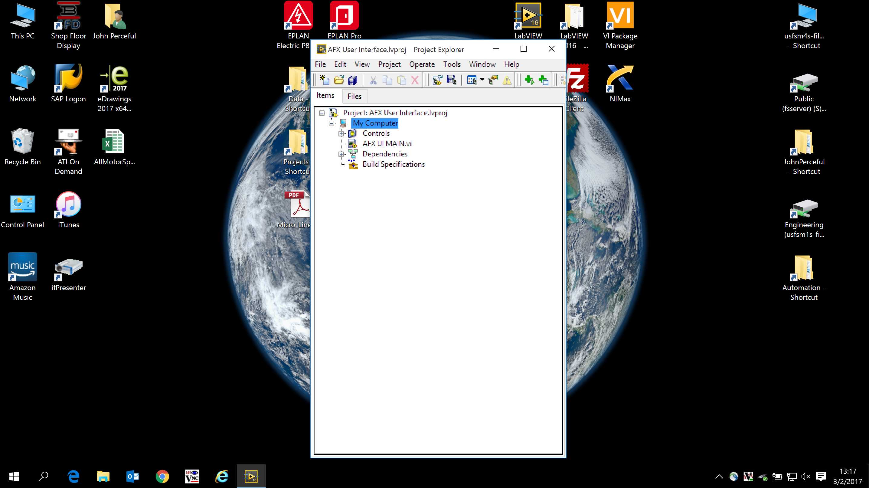

I am using a Lenovo P50s laptop, running Windows 10 with 2 additional monitors connected through the docking station. The built in display resolution is set to 2880x1620. The other monitors are set to 1920x1280. With LabVIEW opened and operating in the built in display the size of all LabVIEW program windows reduce by half when a VI is opened. (See attached images) It stays like this until I close LabVIEW. When I open it again it starts out as "normal" size then reduces again. I am not seeing this with any other programs on my PC. Has anyone seen this before? I am having a difficult time determining if this is a LV or Win10 issue.
