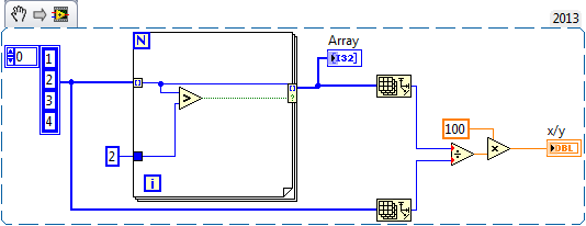

Sorry if this has been covered before! As I am new to Labview and am finding it a bit difficult:mansad: my question is this, I need to design a Vi that will identify transitions between high,low and calculate the number of logic 1s as a percentage of total number of samples, which is up to 100. Can any one help get me started with a few pointers or suggestions on how to build this.

Thank you for your reply. this is an assighment, that i have been given by my university. The assignment would like me to design a vi that will take a TTL square wave of 100 samples, stored in an array.  from this the vi should be able to identify all the high and low logics and display them as a percentage of the 100 samples?

No not yet, as I am new to to LabView and am looking around for ideas or pointers! The array will just have numbers from 5 +- 0.5v logic high and 0 +- 0.5 v logic low

Hopefully you are not lookin for solution stright awaySmiley Happy
because its your homework so better you do it and enjoy.
To start with i am showing you a very rough situation
suppose you have an array. you want to know that how many elements in this array is greater than a certain threshold and what is the overall percentage of such elements to original elements.percentage.png
This image is totally intended for how you can do things in LabVIEW.

Hi neos,
Im having trouble locating some of the parts your using in you VI. Can you tell me what the part on the left is called numbered 1 to 4 or a breath description.

@REXMAN wrote:
Hi neos,
Kind regards.
That's an array constant. You'll probably want an array control instead.
