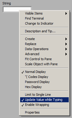

One of the little-known features of string controls is the Update Value while Typing option:
With this option selected, a Value Change event will fire with the Event Structure any time a character is typed (or deleted) in the string control...this is different from the normal behavior of pressing Enter or clicking away from the control to commit its value.  Update Value while Typing can be very handy for UIs that require immediate processing of the value being typed.  One example I can think of is the password entry field on some websites that assesses the "strength" of your password as you type it.  Another simpler example that I've done several times in my UIs is keeping the OK button disabled until a valid value (i.e. non-empty, or unique) is typed in a string.
