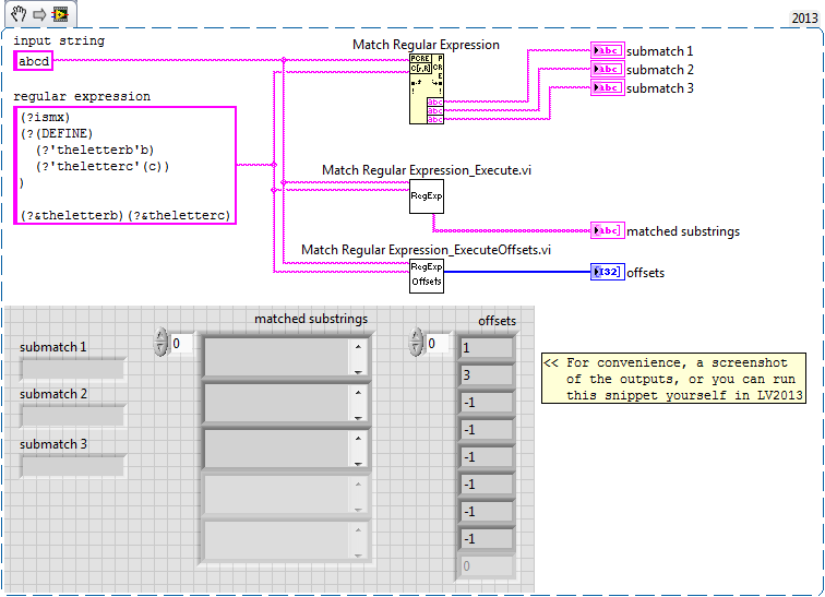

Hi Team! I've run into a new unexpected behavior, this time while using Subroutines in a regular expression.
The following snippet in LV2013 shows a simple subroutine, and the results from three LabVIEW functions.
The interesting part here is the array of offets returned by Execute Offsets -- let's deconstruct this:
Elements 0-1: The Whole Match is from index position 1 to 2 in the string
Elements 2-3: The first submatch is from index position -1 to -1
Elements 4-5: The second submatch is from index position 1 to 2
The unexpected behavior comes in the form of the first submatch -- what is the significance of -1 in this context?
It seems that this "first submatch" should not exist, but its effect propagates up to Execute and up to the Match Regular Expression node in the form of "blank submatches". Snippet below for LV2013:
Message 21 of 25
(1,996 Views)
LabVIEW uses the pcre library (http://pcre.org) to handle parsing the regular expression and doing the matches. The outputs you are seeing in the offsets array are the offsets returned by the pcre library itself (the result of calling the pcre_exec function). The contents of the array are pairs of offsets (first character and one plus last character) for the whole match (the first pair) and then each captured match. It seems that the pcre library (at least the verison that LabVIEW currently uses) considers that defined subroutine to be a submatch that warrants inclusion in the offsets array, even though the specification says that this kind of expression will always fail to match (since it's only used for referring to later by reference). The -1,-1 pair just represents a captured pattern that did not match anything.
tl;dr That's just how the library we use works. It's not behavior defined by LabVIEW. It's behavior defined by pcre.
