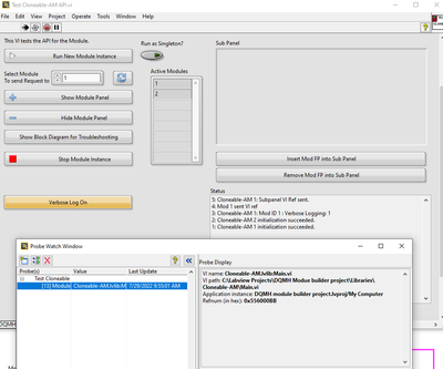

I'm trying to have a cloneable module be able to have its FP be inserted into a subpanel.  I started with the basic DQMN cloneable module templated and I have added a round trip event where the request is just the module ID and the broadcast is the VI reference and module ID from the DQMH module.
In the API tester for my module, I have the broadcast take the VI reference and insert it into the subpanel.
However, when I go to request the subpanel, the subpanel doesn't get updated but when I probe the line with various clones running and requesting the FP reference, I can see the refnumber updating to different values.
I was wondering if anyone knew why I the subpanel isn't updating based on the VI ref being sent to the subpanel.  My best guess is that it has to do with how preallocated clones work, but I'm not sure.
Code is attached and I think it should have everything that you'll need to look at it.  Its written in LV 2015.

You need to make 3 changes to your code:
1. Check the error out from the Insert VI method... that will tell you that you're getting error 1144... you can't insert a VI into a subpanel if its panel is already open (and all DQMH Main VIs are started, by default, with their panels "open", but in Hidden mode):
2. Make sure you close the Main VI panel before sending it to the caller to be inserted into the subpanel:
3. By default, DQMH modules attempt to hide their panels when they close. You'll want to disable this code in Handle Exit.vi, as closing the panel of a VI currently in a subpanel will also close the VI panel that owns the subpanel:

I was going to, but this is going to be a template for modules that will be several layers down for larger projects.  I figured it'd be easier for my calling code to handle the VI refs or create a separate module to handle the VI refs than have the template handle the sub panel.  If this was meant for something smaller I was going to. I'm still pretty new to this style of architecture so to me, it makes sense for the caller to handle the vi referencing if its meant for something bigger whereas the module handling the sub panel would make sense for something smaller.
I found this and this talking about DQMH and subpanels.  Funny enough, the first link goes over exactly what you recommended (sans point 3).  I thought that if I didn't wire the error cluster of the sub panel's invoke node and it threw an error, the generic LV error popup would have happened.  Since the pop up didn't occur, I thought that closing the FP of my module was going to be an issue since I didn't have the VI loaded.  Does DQMH load the FP of its module as hidden or is that standard for LV?
I also added a little checker to the FP close section that doesn't invoke FP.close is the FP's state is already closed.  I tried doing several insert VI refs to my API tester and I ran into an error saying that it couldn't close the module's FP since the FP was already closed.
