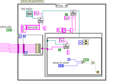

i trying to make a data acqusition loop  for realtime pump on-off control.
in this i am facing a issue, in the daq loop the log data .csv file is continues but tis stops updating the clock of my 3504 eurotherm controller tag in labview ..can anyone pls help me out ..

Hi sanvish,
Your "logging loop" only writes the same data again and again!
Reason: you don't "OBEY DATAFLOW!"
When you want to log "realtime" data (aka current measurement data) then your logging loop needs to get accesss to current measurement data!
What's the purpose of that FOR loop iterating 6 times when you only use the result of the last iteration???

Hi sanvish,
@sanvish wrote:
oops missed to attach
My error analysis is still valid: you don't OBEY DATAFLOW!
There is no loop around your huge case structure, but there should be a loop.
And the loop around that logging code needs to be removed!
On your VI:
  • Clean up the VI!
  • Use subVIs instead of creating copies of the same code fragments again and again…
  • Remove all those Rube-Goldberg constructs…
@sanvish wrote:
I just used the same method in the below link for my VI..
No, you don't!
In that example the "data generation" and the "data logging" is within the same loop!

Hi Gerd,
Even after making subVIs,the corrections i made as per the suggestions . now also the data logging is not correct..only the last value is recorded in .csv file.. we need continues recording of data
