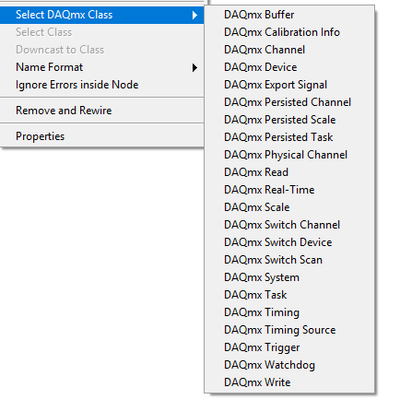

I inherited some code using DAQmx, and it has some property nodes I can't seem to unbreak.
It seems to be the "DAQmx Event" class but that's missing from my available class list
Anyone know how to get access to this DAQmx node class? Using LabVIEW 2023 Q3 and DAQmx 2025 q1.
Attached example saved in 2017.

There is no DAQmx Event Class; never seen it before. You use an event node. Not sure how you are exposing the DAQmx Event Class, must be a hidden INI file setting.
(1,405 Views)
"DAQmx Timing" has a SampClk.Rate property. Maybe it's that? Could you post some code to show it in context? (Honestly a picture might even work here... we just need to see what the wire is coming from and what node it's trying to use. So maybe add where the wire goes in your image.)

Based on context I think the attached VI is the intended usage.
I can guess the correct nodes but I wonder how the original ones got messed up...
(1,373 Views)
You want to use the properties in the disabled node.
