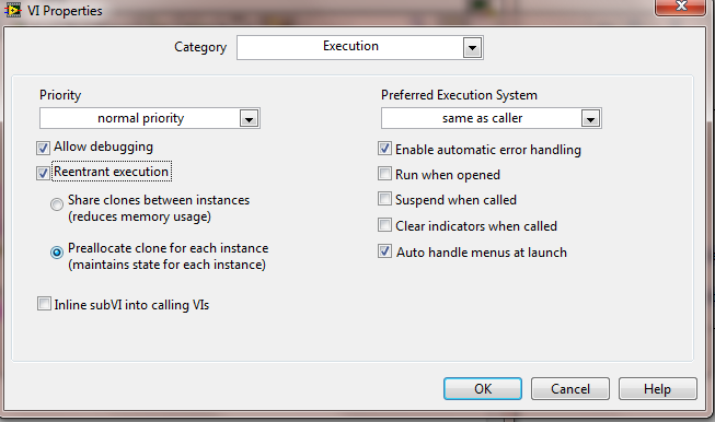

Viper,
You don't need to have the wrapper, but what you do need is to set the VI to reentrant for it to work. You can do this be going to File->VI Properties. The screen shot below shows the options you should select.
By making the VI reentrant and preallocating the clone, you are able to have exactly what you need. Let me know if you have any other questions.

(3,556 Views)
Indeed making both reentrant makes it work. Smiley Happy Your example does indeed make it more simple but I wanted it to be arbitrary (in the number of uses)  for the prompt so that it could work on any number of inputs that I need to get from the operator. I didn't want to have to add specifically for each case.
