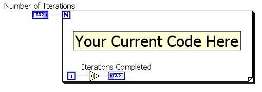

Hi Harsh,
It looks like the code you submitted is the actual message commands you are sending to the instrument. Because I don't have the same instrument, these are useless to me. I am more interested in the actual block diagram that you are currently employing (this is your source code.)
But judging from your last post, you have already done the bulk of the work, and have a viable solution for one iteration of the program. A very simple solution to your problem is pictured below.
Just place a for loop around your current program and wire a control to the loop count. You can then change the number of iterations and then run the VI. I have included an indicator on the loop iteration terminal in order to give some feedback to the user in this example.
There are more robust solutions to this problem, but this is a good starting point.
