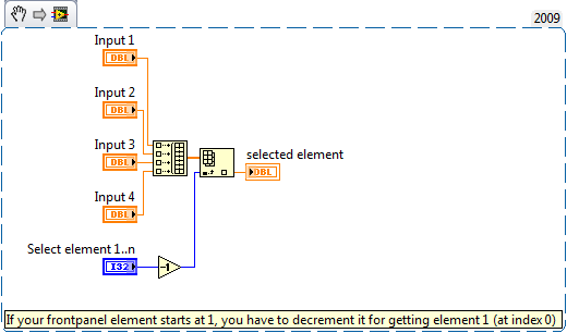

Creating a two bit multiplexer
How could two bit multiplexer could be created using labview.
That is there would be four inputs and one output.
The control of this should be numerically i.e when the numeric select control has input 1, the first input goes to the output and when it has 2 the second input goes to the output and so on.
I think that its not very difficult but needs an idea to be picked for the solution.

there might be several option, depending on what your "real" application should do at the end.
First question:
Is it fixed in your app, that you have 4 single values
Attached you´ll find two examples of how a kind of multiplexing could be done, if your selector is a numeric value.
Option1:
Build an array of the 4 values, and then use the "Index Array" function  for selecting one of the data points and give it to the output.
 -> Very easy to add new input lines to this "multiplexer"
 -> Remember that array indexing starts at index =, if you want to give the user a selection from 1 on.. yo have to decrement this for reading element at position 0 (which is the first in the array).

The function you point to - "select" is a "1bit-Multiplexer". You can wire only boolean values to the selection input.
That means, for creating a 2bit or more multiplexer, you have to struggle with cascaded select functions.
The selector from the Comparison pallette is a simple "If/Else" construct, if you need more complex ones, use the Case structure or, for just selecting from several values, an "index array"
