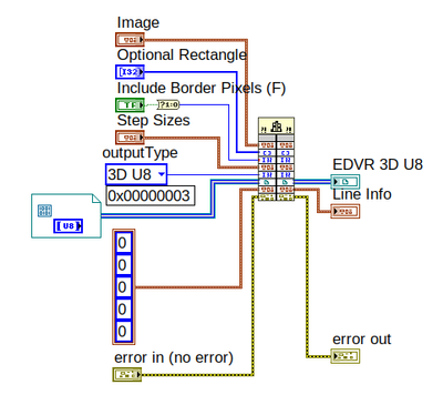

There's exactly one documented standard VI which makes use of EDVRs, that is the the "IMAQ ImageToEDVR" VI. which is polymorphic and dispatches into the various data types.imaq_edvr.png
All of the polymorphics call into a function "LV_ImageToEDVR" of an IMAQ external library.edvr_call.png
Whatever is pointed to by the "edvr" parameter is some kind of descriptor buffer, parts of which must be populated by the callee; I assume, at the least somewhere the pointer to the actual data, its type and size must be stored in that.
But the exact layout of whatever structure this is, I found no documentation for. I actually did try to figure it out, by writing my own external library which simply dumped 256 bytes starting at where the "edvr" parameter points to, and also did this with a regular data value reference. But in neither case within those first 256 bytes there was a value to be found, which would match the address of the array referenced by that very data value reference. However I can clearly discern some form of counter and handle values.
So what I want to know right now is, how to create external data value references, which means I need to know the structure of whatever is pointed to by what's passed to a function parameter a EDVR is connected to. And I presume, because whatever this structure contains has no pointers, there must be some LabVIEW function be called to actually register a EDVR to get the (presumably) handle values, I could see in my memory dumps.
