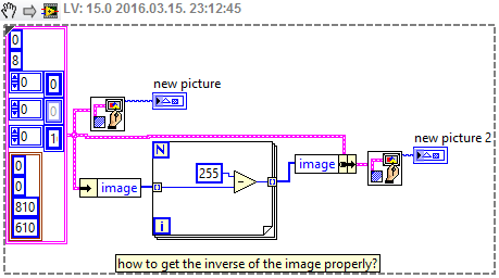

I would like to create the complementer of a 8-bit image. I am doing it wrong in the example below, how can it be done properly?
thanks!
(edit: the FOR loop obviously not needed)

For an 8-bit image the points are indices into the color array.  What you should do is leave the indices alone and for each color in the color array find its complement:
(3,460 Views)
Clear, thanks!
