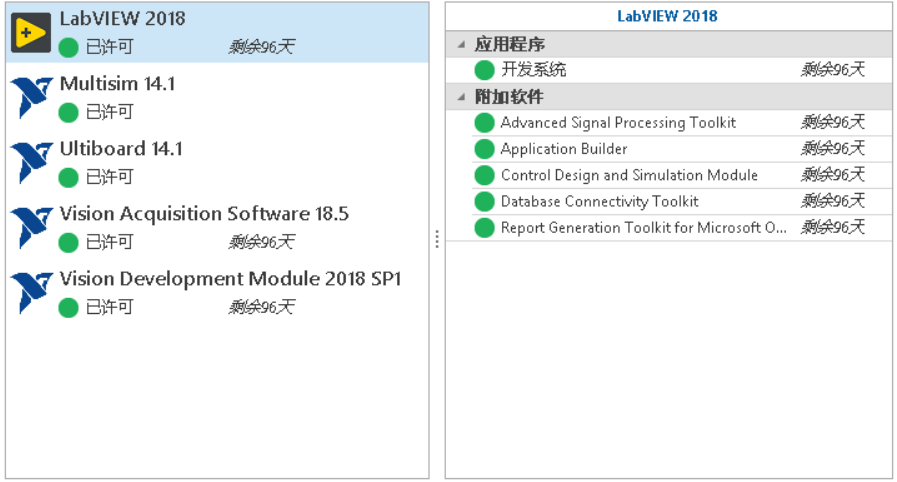

     Another way to see if these programs are installed is to open MAX and look under the Software Tab.  In fact, you could take a screenshot of what MAX lists under Software and attach it to your Reply, which will be helpful.
     You should also open the Devices and Interfaces tab in MAX, where you should see your Laptop's camera.  Here's what I see on my laptop:
Laptop Devices seen by MAXLaptop Devices seen by MAX
Notice the first device is "Integrated Webcam".  I'm pretty sure you need the Vision Acquisition Software to see this show up.
Finally, to really see what is installed and licensed, go to the Start Menu, find the National Instruments folder, and look inside for NI License Manager.  Run that, and it will show you what NI Software you have installed and have activated.
Let us know what you find.

Hi Bob,
Thank you so much for your reply.
Here is what I get in the "software" of "MAX":
Here is what I get in Devices:
Here is what I get in NI Licenses Managers, I am sorry my system language is in Chinese. I hope it will not affect  your checking:
Thank you so much for your help!
Sincerely,
Xiaowei
(4,188 Views)
