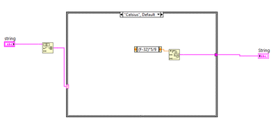

I'm stuck with how to connect the input string to the function node and display the result with the text.

Using string subset will be very limiting. You will only be able to enter temperatures that are 4 characters long. I would use something like "match pattern" instead. You can even find how many places are past the decimal point and make the output temperature have the same precision as the input temperature.
However there is a bug, when I enter in -40 F or C it doesn't perform a conversion, it just outputs -40 again. Can you figure out why? 🙂
Read the help documentation. (Ctrl+h) will bring up the hover window, then you can click for more detailed help. You will find that the variable "F" does not belong in an expression node.
Actually, almost any character will work, including uppercase F. 😄
There is an almost unlimited possibility for variables, with the only restriction that it cannot be "pi" and there cannot be more than one variable name per node. Even the following works fine.

If you can assume that the input is well formed (no extra characters or spaces), You could do the following (It would be easy to expand the output format to include more text):
(Also make a default case that outputs NaN for unexpected inputs)

@altenbach wrote:
Oh man, I've got a whole omelette on my face. Thanks for pointing this out!
