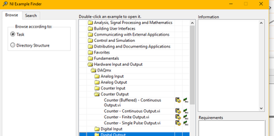

Try adding a timing node, Implicit with Continuous samples, before the task starts:
(955 Views)
I think you have several problems here.  Take a look at the examples in Find Examples...
