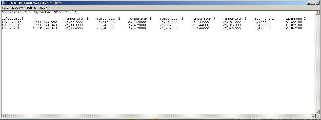

Even my data logging part works well. But both together is not working the way I want to.
I am pretty sure that I have to use a While Loop but I don't know where to put it. I tried everything put my txt data looks always like in the attached jpg.
Can you help me fix my problem? Do I really have to use a While Loop or is there a function I don't know yet?

Yes, in order to continuously read, you must use a while loop. It should be around the scan and read function. The configuration should be outside the loop. The logging you have inside the loop makes no sense. I would suggest a producer/consumer design.

Okay I got it.
I just deleted the two While Loops and put one around everything.
Now it works! 🙂
