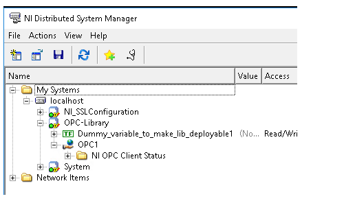

Paolo, can you tell more about the error message in registry "getting a class id"? Somehow the access to the local OPC-server must be blocked.
My latest tests suggest that the windows firewall path might be irrelevant.(It came from my observation that a not working pc goes to a working pc each time after I get the question from windows firewall to "allow this program...")
I found a local pc here at the office where I could try to install everything again (no, Labview runtime 2012, OPC server 2012 and DSC runtime 2012 was already installed).
When I started my Labviewprogram it deploys the Library "OPC-Library" ok.
In distributed system manager it looks like:

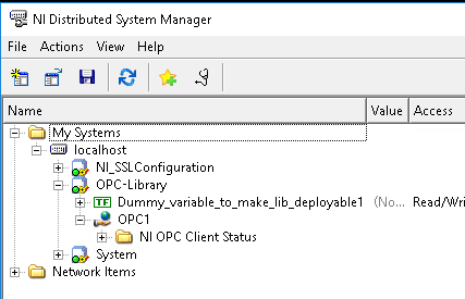

So no PLC available under OPC1 (see below for how it looks when ok.)
Steps I took, and these made this PC working:
  1. Enable diagnostics in OPC1 (file attached, shows access denied).
  2. Opened the OPC servers configuration, Save As... just to give my OPC config a new name.
  3. Put a shortcut into Common startup to start my program.
  4. Restarted the PC
  5. Now DSM shows access to OPC server:
  6. So it works for this PC!
