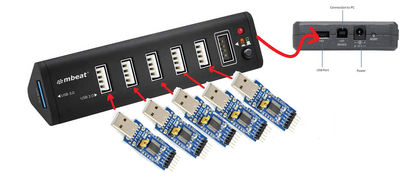

Hi
First of all, I did not fully understand what you said. But I would like to explain the situation a little more.
I connected a usb hub to the usb port on the NI-myrio and attached a serial converter to each of the USB hub ports.
When I test with NI-visa, a comport address is assigned for each attached device. For example, 5 com ports appear on the NI-myrio in addition to the internal default 2 ports.
But devices are assigned random port numbers. What I want to do (which might sound a bit crazy) is to set the com port number for each device plugged in.
I did not create any code snippet. Because first I want to understand if it is possible to set the com port numbers to be assigned.

Your question boils down to "How do I do such-and-such", and my comment was "What (really) do you want to do?", or "Why are you doing such-and-such?".  I think of the myRIO (and other RIO devices) as superb configurable I/O devices, particularly when precise timing and synchronization are desired.  Devices that use serial communication, on the other hand, are frequently less precise with timing and synchronization.  So to paraphrase my remarks another way, "Why plug the USB Hub into the myRIO instead of into the PC?".  I have had a little experience with reading from multiple Serial Ports (using a concentrator that bundled the data and set it over TCP/IP), and the PC lapped it right up.
P.S. -- "Because it is there" is not the response I'm looking for in the question "Why the myRIO?".

I solved this problem, I changed the name of the specified comport via NI-Max and used it this way. Every time I use the name of the inserted usb device, not the com port number.
Thank you for the reply.
