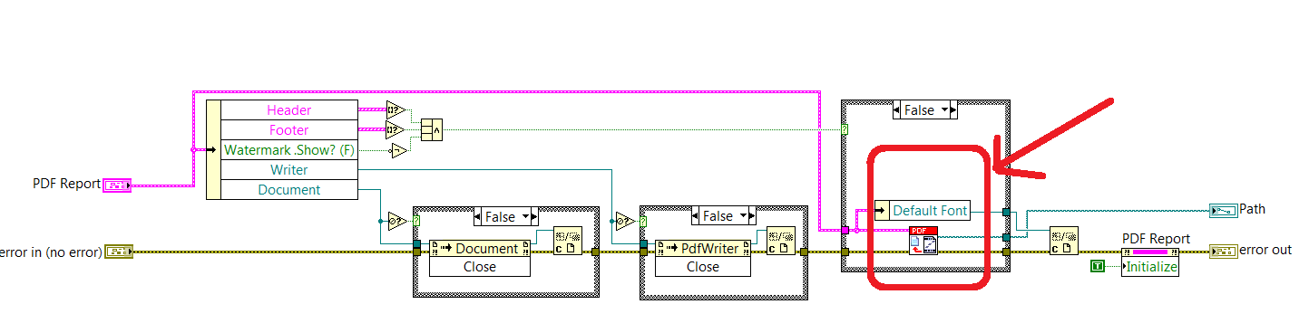

What you want to do is done by "Append Header, Footer and Watermark.vi" in "Close PDF.vi".
If we provide the mandatory informations, this VI could run "as a standalone".
The XControl "PDF Report" needs:
1) a path (the actual PDF file you want to modify);
2) at least a Header  or a Footer;
3) "Page dimensions [ ]" in point (1 inch = 72 points)
4) a font.
You also have to modify (to add a white background color):
user.lib\Exaprom PDF\VIs\Low level\Header, Footer and Watermark Low level\Header Footer Add Cell.vi

Wow fantastic.  There are some more things I need to do to make it happy but it works great.  I also had to set the background color in the other case, where the curreng page number is not greater or equal to the Start Page.  I also found your VI for making the font reference so that helped.
As for the Page Dimensions I wrote a VI that would use the PDFReader and read the existing PDF to get the Width, Height, and orientation for all pages.  I couldn't find a property to read back the margins.  At the moment I'm just going to assume 1 inch (72 px) on all sides but to be more generic it would be nice if I could read this back.  Is that property exposed?  If not this will still work.
