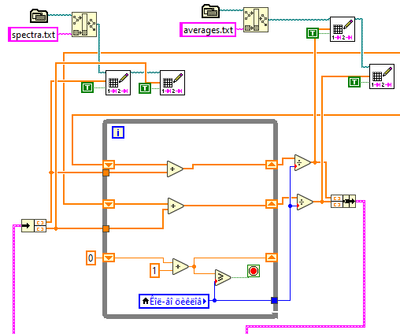

Collect data into an array and average it.
You misunderstood me.
I just want to know if something needs to be changed in the picture.
Array (2d) of data comes from 1. From 2, averaging occurs. Everything works here. But I want to check - right or wrong. To do this, I want to collect several arrays from 3 and write them to txt (excel).
I can't invent of how to take a 1d array from each iteration and write to a file. Or make a multidimensional array of 1d arrays and then save it.

Hi Fizikaman,
The counter used to compare with "Kol-wo ciklow" should be an integer. No need for any orange float here.
As has been said before: the inner while loop is non-sense! Anchor the shift registers at the outer loop border!
Why don't you attach your VI? We cannot debug or edit images using LabVIEW…
Learn the LabVIEW basics: using an autoindexing tunnel converts your 1D array into a 2D array.
Read the help on WriteDelimitedFile function to learn how to save 1D or 2D arrays…
Edit after merging your threads:
  • Please attach the current state of your VI. The VI above is nearly 3 weeks old by now…
  • Learn about DATAFLOW and avoid local variables (because of race conditions).
  • Think about usage of "Formula" ExpressVIs for those very simple formulas. Do you really need numeric constants with 32 decimal digits for handling measurement data? (This is numerical non-sense!)

Nearly. In that thread, I asked how to average the data.
And in this thread I am asking how to check the averaging I wrote.
The fact is that it will not be possible to simply save, since the last array is saved, and I need all the arrays. That is, 10 measurements pass and I need to save 10 arrays in order to independently check the data averaging.

Perhaps I am not explaining exactly. I don't just need to save the file (I have already implemented such a code and it works with a single measurement). I need to run 10, 20, 50, 100 cycles and save each cycle to check if the averaging works correctly.
Message 16 of 19
(1,169 Views)
I assume that you want to save the data only to look at it once, check the algorithm for correctness and then delete the file.
The fastest way to do this is like in the image below. It is not a good way to do this. I have alread posted the link to the VI above.
Message 17 of 19
(1,159 Views)
Yes, you understand correctly. I want to look all arrays and compare with the final one.
Thanks. Now I will try to do so.
