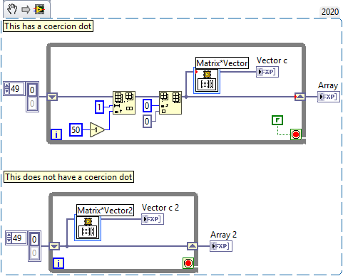

Greetings,
I cannot get a coercion dot on a bit of LabVIEW FPGA code to go away. The dot is on the input to the matrix*vector block

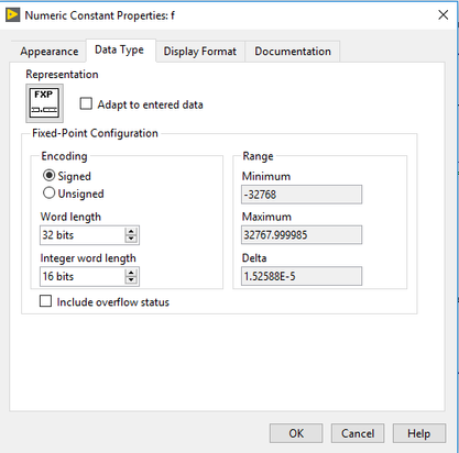

Before it, I have an FXP conversion to set the FXP word lengths,
These line up with what is selected in the matrix multiply vector form (the are both FXP of 32, 16). The code that loads the values into the A matrix is also set at FXP 32,16.
Lastly, on the right-hand side of the code, I have another matrix*vector also with an FXP conversion right before it in a for loop, but that one is working just fine.
Any idea on what is causing this coercion dot?  I have also attached the code if this helps.
Thanks in advance!

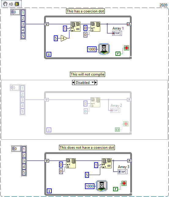

I have continued to work on this problem and I think my issue is the fact that I am deleting an element from, and adding an element to my array. This changes the size of my array and LabVIEW does not know how to handle this. See the code below (and attached). See the attached code, the for loop on the bottom does not have coercion dots, but the one on top has 2 (one on the shift register, one at the matrix-vector multiply). I suspect this is because the size of the array goes from 50 to 49 to 50 during the element shift.
I was told maybe coercion dot is correcting the size of the array rather than shifting the element type? However, I don't see that functionality in this info page about coercion dots.
https://www.ni.com/docs/en-US/bundle/labview/page/coercion-dots.html
Is there a better way to shift all the elements in an array up (or down) and place a new element at the end (start) of the array? I would like to get rid of the coercion dot so I can move forward without worrying about future side effects.

I think I figured it out, flipping the insert array and delete array functions seems to fix it. For some reason, having the array change in size from 50, to 51 back to 50 is OK, but 50-49-50 is not. I even tried to just insert an array, but this results in a shift register that cannot resolve its size.
