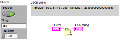

I have a few clusters that contain data that I am putting in a database using a Python script. I want to label things as they go into the database based off of what the element name in the cluster is and I want to do this dynamically so that if I change the name of the elements in the cluster it will change what I am sending to the python script and go in with the new name. I can not find a way to dynamically create an array or any data structure that holds the name of the elements in a cluster. In short I want to grab a cluster and output some data structure with the list of element names from the cluster. Any information on this would be great!

Since you are passing the data to Python I would recommend flattening your clusters to JSON.

Flattening to JSON seems to be the clear answer here.
Note that the label of the cluster itself is not included in the JSON string, though.
