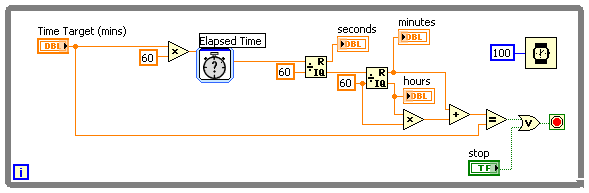

Hi guys. I want to realize a clock that show me hours and minutes. I was using the elapsed time.
Could you check if this solution is fine?Because I'm not so sure if I have done mistakes.

The first issue I see right off the top is your elapsed time in seconds is never going to equal 60, at least not every minute like you expect it to occur.

you can always use "tic count"

Personally, I'd convert the elapsed seconds to a timestamp and play around with the timestamp display to be "HH:MM:SS".

something like this...

Why convert to a time stamp?  You can drop a numeric indicator, go into the display format properties, and set it for relative time.

also, you are right....
