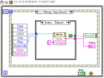

@Brandon.Baxter wrote:
Hello Bill, I like the "Key Down?" event because you can discard the character an append whatever you want as an end, like a sync word for example
That's a nice way to handle it, given the "revised" requirements.  😉
Bill

I think we are dealing with a race condition and I would call it a bug. Note that things work fine if we are in execution highlighting mode or if we slightly delay the write to the local variable e.g. as follows:
(input is set to update while typing)
Message 12 of 24
(2,448 Views)
It also seems to work properly if we use a value property node instead of the local variable to clear the string.

Here is a comparison of two seemingly functionally identical code version (one with a local, one with a value property).
Clearly some gears don't mesh correctly when using a local variable. This should work!

Hello Bob I was toying with an idea similar to the one you presented.
The approach I'm going for is like text in an Instant messaging window. I.e. type stuff, enter, type more stuff enter. I started with the solution you posted but I found did not flow well having to click something arbitrary to trigger the value change event. The next thing I did was use a Send button rather than the value change to make it more intuitive to an end user. Ultimately I settled on pressing Enter to send the data to my consumer loop and clear the string because for this situation it is very Intuitive and it keeps the flow going to the end user.
Message 17 of 24
(2,389 Views)
In that case, I would just set control to 'limit to single line' and use a 'Send' button that has a binding to the 'Enter' key.
Message 18 of 24
(2,386 Views)
This is what I settled with. I would have liked to be able to do it without setting "Update Value While Typing". But other than that I'm very happy with the way the UI flows and the way this fits into my code.
