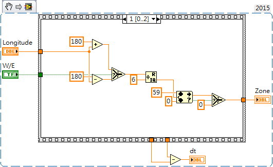

I think this will be a fairly basic question, but I am having trouble choosing the best function. Here's what I want to do:
I have a GPS feed in my main VI giving Latitude and Longitude. I want to use the Longitude value to determine which UTM zone I'm in. There are 60 zones, each with a width of six degrees. With a value of Longitude, I need to look up a table or an array to find which zone number is. Zone 1 covers longitude 180° to 174° W; zone numbering increases eastward to zone 60, which covers longitude 174° to 180° E. For example, with a longitude of 153 (here in Brisbane) the function should choose the value of 56 and spit it out. The only thing that changes is my current longitude, so the table with the zone values and corresponding longitude values never needs to be updated.

Hi KarlosAmigos
I'd just like to do some manipulation of the input...
I hope I'm not misunderstand your question, and I'm wondering if there's other more efficient way...

This is a simple Math problem.  Take a piece of paper, write one Zone boundary (say, 180°) in it, and beside it put the Zone number (60).  Now do the next Zone, and the next, and the next.  Do you see a pattern?  Can you think of a mathematical function that (a) takes "integer" jumps (since there's no Zone 59.4) and (b) is related, somehow, to the width of the Zone (6°)?  Now all you have to do is get the offset and the sign right and (you'll forgive the atrocious pun) "Bob's Your Uncle".

Thanks William,
Using just a mathematical manipulation works like a charm. With one minor addition.
To get the right zone, I had to add an increment function just after the quotient and remainder function. I have tried different coordinates from both hemisphere's and now it always returns the right zone. Many thanks for this solution!
