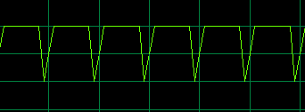

When a customer creates a 10-second pattern, it is repeatedly executed in LabVIEW.
Looking at the resulting graph, it seems to work normally (Figure 1).
However, the actual time is about 13 seconds.
So we wanted the actual running time of one loop.
The program configuration repeats the loop once per second.
Wait Until Next ms Multiple Function is set to 1000 ms (Figure 2).
It seems to me that Wait Until Next ms Multiple Function(1s) + other actions within the loop (0.3s) = 1.3s.
Can you tell me how can I calculate the time it takes for 1 iteration (10 points)?

The loop I was trying to make repeats once per second
It's actually a problem that takes more than 1 second.
Is there any way to find out how much time has elapsed in 10 loops (10 points)?

Could I get a hint on how to get the time it takes to iterate this loop 10 times?
Message 9 of 10
(4,884 Views)
Accepted by topic author kimtae
Hi kim,
Take the timestamp before and after that loop and subtract both values…
