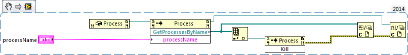

I use the .net Framework (getProcessesByName) for looking up a process, but now I want to check if that prozess is 32 or 64 Bit.
Has someone an idea?

I got the Code (under this post) from another User and now I want to change the code so I can look that up. I thought that not switching off .net would be the best idea.

The Process reference has a lot of Properties that you can access. Maybe one of these can be analyzed to figure out if the process is 64bit or 32bit.

Try here: http://stackoverflow.com/questions/1953377/how-to-determine-programmatically-whether-a-particular-pr...
You should be able to get the IntPtr.Size (the first suggestion) from the Handle property of the process.

The IntPtr.Size was a good idea, but it only works with the program itself, so I can check if Labview is a 32 or 64 Bit system but no other programs.

There are other suggested methods in that thread, and other linked threads inside it.
Calling IsWow64Process from kernel32.dll from a call library function node would do it.
BOOL WINAPI IsWow64Process(
  _In_  HANDLE hProcess,
  _Out_ PBOOL  Wow64Process
This function supposedly returns FALSE if the process in question is running natively. That means the only time it is TRUE is if the process is a 32 bit process under Windows 64 Bit. So you would first have to determine if you run under 64 Bit Windows and if so then if this function returns FALSE you have a 64 bit process. Otherwise you always have a 32 bit process.
I'm pretty sure .Net has something along this function as a method of the Process class.
