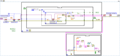

I want to acquire analog input from a sensor and save it to a file. To do this I am using producer-consumer WHILE loops. Inside the producer loop is a FOR loop within a FOR loop. The outer FOR loop is for the number of files I want to save. The inner FOR loop determines how many samples are saved. I then use Channel wires to stream the data between the WHILE loops.
I would like to save multiple files, each having 30 samples, and an index in its filename (1,2,3,....).
The attached VI doesn't send the data across to the consumer loop until the outer FOR loop is exited. How do I resolve this issue?

In principle, you can run three Streams in parallel (as you have done, the Producer having an "Index" (I32) that "counts" the sample (counting from 1 to # of Files, the "N" of the For loop, plus a concatenated array (3 back-to-back) of A/D samples, plus another loop just carrying a "Stop" command, and running once in the outer While loop.
The Stream channel is distinguished by having support for "Sentinels", typically a Boolean that signals "All Done" or "Data Bad".  The key to using the Stream Sentinels (one called "element valid? (T)", the other "last element? (F)") is that if you write to one or both Sentinels on the Producer end, you must read from those Sentinels on the Consumer side.  You don't do this -- you only write "Last Element" to the Data Array Stream, which causes the Stream to stop working after the Consumer "see" the "Last Element".
Another problem is that if your outmost While Loop runs more than once, you'll end up using the same File Names when you start processing data from the second iteration of the Producer loop!  So if the For Loop goes "1, 2, 3" and the While Loop goes "1, 2, 3, ...", the Producer will create names "X1, X2, X3, X1, X2, X3, ...".

The key steps are 3 and 4.  If there is no Error, and the Stop button isn't pressed, you want to go back to Step 2 and keep generating, otherwise you go to Step 4.  In Step 4, you send one more Stream message, with "last element?" set to True, and "valid data?" set to False, and you wire True to the While Loop's Stop Terminal.  That stops the Producer.
On the Consumer side, put all the "Consuming code" (building the file name and writing the File) inside a Case Statement, with the Channel Reader "outside" the Case.  Wire the Data into the Case, and wire "last element?" to the Case Selector.  The code you just put into the Case Statement is the False case (you want to process everything except the final Sentinel value), and you leave the True case empty, but wire "last element?" to the Stop.  And did I say "Get rid of the Wait in the Consumer"?  [The Consumer can't run unless the Producer sends it data, and when the Producer sends its final "last element?" data, the Consumer can simply exit].
Whew.  Now fix your code.
So what do you do?  Replace the three Streams by a single Stream and use the Sentinels to tell the Consumer that the Producer has finished.  Note that you can make a cluster with "Sequence #" (the index of the For Loop +1) and "Triple Sample" (the output from the For Loop).
So how do you stop the loop(s)?  You need to send one more Stream element with "compatible data" (any I32 value for Sequence # and an empty 1D Array of Dbl for "A/D Data") through a Stream Writer with "element valid?" of False and "last element?" of True.  How do you do this?

@Bob_Schor, please see the attached VI.
I am still figuring out how to convert this into a state machine for my overall task, which would include other functions and associated tasks. The attached VI makes use of channel wires to transmit AI samples read periodically once a user input is provided (Boolean switch). It appears to be doing what I expect it to, but I want to ensure I am not making any major slip-ups in channel wires (especially once stopping the loops).

@Bob Schor: Thank you for your detailed response. Here is how the VI looks like now. If there are still corrections, please do let me know. Also, since data acquisition wasn't originally a part of the question, it's discussed in a different thread here

I'm assuming you attached a LabVIEW "snippet", saved from LabVIEW 2022.  My main LabVIEW installation is 2019 SP1 (32-bit), or LabVIEW 2021 SP1 (32-b9t).
What I'd suggest is that you build a small Project with your main Program and enough sub-VIs that it will compile.  Do a "Save for Previous Version" and specify LabVIEW 2019 (or 2021).  You'll get a Folder, which may have bits and pieces of C:\Program Files (x86)\National Instruments -- I don't need these folders, but the one in C;\Users\<Your Username>\Documents\LabVIEW Data\\<Project Folder> -- I need the Project Folder.  Note that if it is large (probably won't be), you can do a right-click "Send To:", "Compressed (zipped) Folder".
You can check that it contains a Project file that you can click and see your code and all the VIs it calls.  In particular, the picture you posted doesn't show me how you shut down the Producer/Consumer -- I assume you are using the Sentinel feature of the Stream Channel Wire ...
