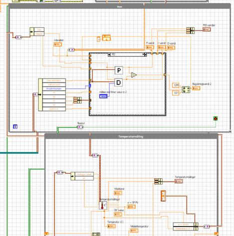

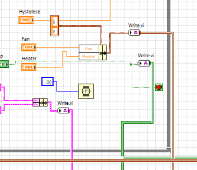

I am currently developing a program in LabVIEW, but I am having some trouble with my channel wires. It seems that they are reading and writing incorrectly, even though I believe I have connected them properly. The names they read appear to be linked to another channel wire (see Pictures 3 & 4).
I have tried deleting the contents of the ChannelInstances folder, but the issue persists. We are only allowed to use tag-endpoints, but it only works with a stream-endpoint (see Pictures 1 & 2).
I would really appreciate any help!
I have attached some screenshots of the block diagram in this thread. Let me know if you need more information.

I apologize for attaching a code that does not work. I am not yet confident in LabVIEW, and the VI is part of a big project with Digilent for one of my university courses, so I should have known that it would be unreadable. I asked my professor what to do, but they did not know what was wrong, so they asked me to post in this forum.
My problem with the wires occurs when I bundle two numeric (DBL) values by name and then use a channel wire to transfer the values. It seems that the wire writes and reads a different name when I use the "Unbundle by Name" feature. The names it writes and reads are not even part of the project.
I have attached a VI (that I hope works) to illustrate what happens when I use different types of wires. It works with the Messenger Channel Wire, but my professor prefers that we only use Tag Channel Wires.
Once again, I apologize for the non-working code and for not being very skilled in LabVIEW. Thank you for the reply
