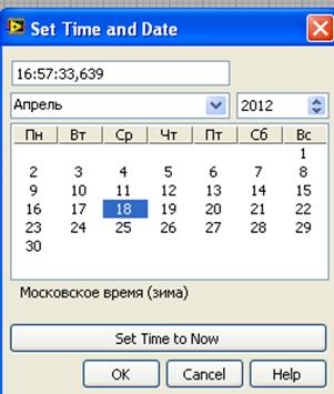

Hi. How I can change the language of time/date browse button. For example,
i want to change the caption of button "Set time to Now", to the "Time"? Is it possible?

Hi James-D,
I use English version of LabVIEW, but my OS is Russian. Yes, I want change language of the buttins, but also want to know, is it possible to change text of button.
So, does anybody know answer to any questions?
P.S. I didn`t understand, why wriiten "Московская время (зима)" in Russian language, but buttons in English?
(3,227 Views)
Accepted by topic author rusl
The dialog is a VI that is part of the LabVIEW package.
You can make a copy of this VI and edit the button text as you want.
look for picktime.vi in your \resource\dialog\ subdirectory of your LabVIEW installation.
